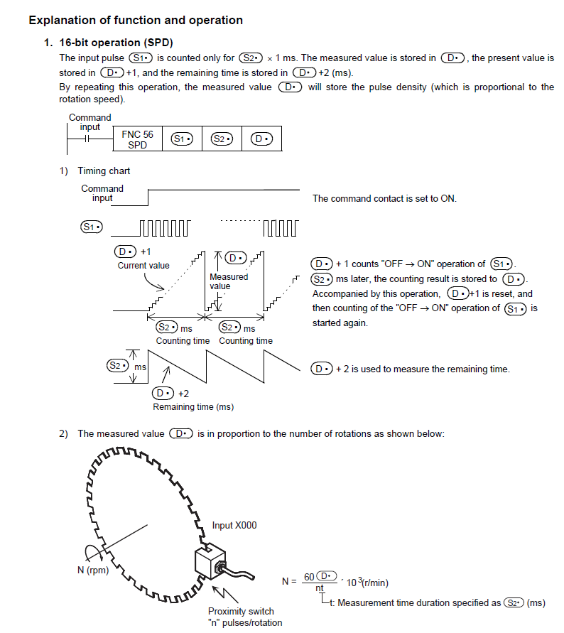

Posted 22 May 2020 (edited) Hello all I am have FX3G PLC, where i am trying to use SPD function for speed monitoring and controling. currently i am working on software only. I am using x4 as input (s1) , sk1000 (s2), and d4 (D) in monitoring mode when i am forcing X4 to ON/OFF , there is no any value change occure on d4 i have tried to change the s2 value from k1000 to k10000, but not fruitful i need your valuable support to confirm that my primary setup is correct or not and what things are required/missing attached program screeshot Edited 22 May 2020 by Aijaz Share this post Link to post Share on other sites
Posted 23 May 2020 Good morning I trust you are well. I would suggest shortening your time. Please see attached picture on how to calculate the time 1 person likes this Share this post Link to post Share on other sites
Posted 23 May 2020 The SPD instruction does not work in simulation mode. 2 people like this Share this post Link to post Share on other sites
Posted 23 May 2020 That means forcing ON/OFF wont give me any value at output? Share this post Link to post Share on other sites
Posted 23 May 2020 Good Day sir, First of all i would like to say thank you for your response on my post. I have one query , regarded the SPD function, is it possible to simulate like forcing ON/OFF the input used for SPD and get result at out put. what i cam to know from that it require a minimum frequency at input which can not be achieved by manually forcing ON/OFF the input (e.g X004) of SPD If it really require a minimum frequency at input, then is there any way to simulate an input with particular frequency (without hardware Share this post Link to post Share on other sites
Posted 23 May 2020 simply check the reponses you already got. the very first one shows info from the page of the manual. it shows exactly what SPD does, with all parameters etc. as well as equation it is built on. that equation is the key to do any simulation without actual PLC hardware. minimum frequency is determined by value in S2. Share this post Link to post Share on other sites
